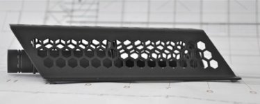

Boundary mics are a good idea but have the disadvantage that they can pick up footfall noise and can get trodden on.
An alternative is to use a "Turtle". This protects the mic. from being trodden on and also incporporates Rycote "Lyre" supensions to protect the mic. from footfall noises. You can use it with any small diaphragm condenser mic. with a 19-21mm diameter. And when you don't need the boundary mic. you can unclip the mic. and use it as normal.
I hope this helps.
