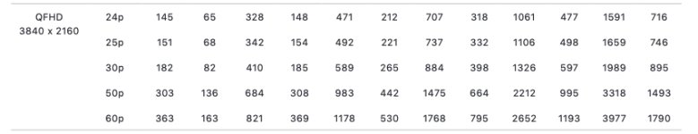

As mentioned above, it's 471 for 422.
And 328 for LT and 707 for HQ.
No, I'm not. Those numbers came from a data calculator. Interestingly (or not) I checked the numbers on another data calculator (AJA) and it gives the figure 530.79 Mb/s for QHD at 24p but only 238.5 GBs an hour. I checked them again on Arri's data calculator and they said 553Mb/s and 240GBs an hour. I don't know where you got your figures from but I do know I didn't make mine up.

Stop using data calculators, man - and just post the numbers from the people who created it.
Page #24 - https://www.apple.com/final-cut-pro/docs/Apple_ProRes_White_Paper.pdf

To be fair, those are "target" bit rates, not absolute. They even use the word "approximate". Encode the same video file to ProRes using two different systems you'll get two different bit rates. Also, I don't think it's silly to use a data calculator made by a manufacturer of the type of recorder the OP is talking about using or one by a trusted manufacturer like ARRI. These things are guides.

Actually, I searched for that White Paper and only came up with the one from 2013 which is why I used the calculator!

Really? I thought ProRes was constant bitrate whereas ProRes raw is variable
Apple calls it a variable bit rate in the white paper (which I could have sworn I didn't see that before over the years).
I checked some from Blackmagic earlier and they varied.
But didn't have anything else (I archive everything in H.264) to compare them too (i.e. a different scene or different hardware like Atomos' ProRes or RED's ProRes, etc).
A good test would be to set up two pieces of equipment and film the same scene and compare files.
I think variability anywhere proves variability
But what are those data calculators reporting? Maxima? Seems like they're not reporting the target rates
I just checked a few ProRes files in Quicktime:
* from my FS5/Atomos, DCI 4K 60p: ProRes 422 was 1.13 Gbit/s; ProRes LT was anywhere from about 720-800 Mbit/s
* FS5/Atomos, DCI 4K 24p: ProRes LT was 300-315 Mbit/s
* BMPCC4K, UHD 24p: ProRes HQ was about 700 Mbit/s; ProRes LT was around 320 Mbit/s
* OG BMPCC, HD 24p: ProRes HQ was about 178 Mbit/s
