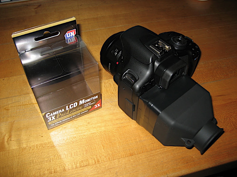

After much lurking here and reading about the various hood loupes that are available for DSLRs I decided I could assemble one myself.
Here is the link to the UN ProLoupe 3x magnification screen loupe (UNX-8506) that I bought:
http://cgi.ebay.com/ws/eBayISAPI.dl...889061&ssPageName=STRK:MEWAX:IT#ht_3387wt_941
I have combined it with a cheap pop-up shade for my camera (Canon 500D/T1i) like this:
http://www.ecrater.com/product.php?pid=5163142

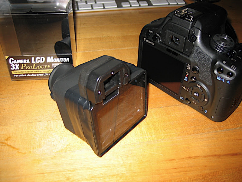

I simply "press fit" the loupe hood over the "popped up" shade and taped over the light leaks to make my own Zacuto Z-Finder-like screen hood. I have attached photos of the assembled hood. In one of the photos the glass in the pop up shade appears cracked... but I can assure you that it is not.

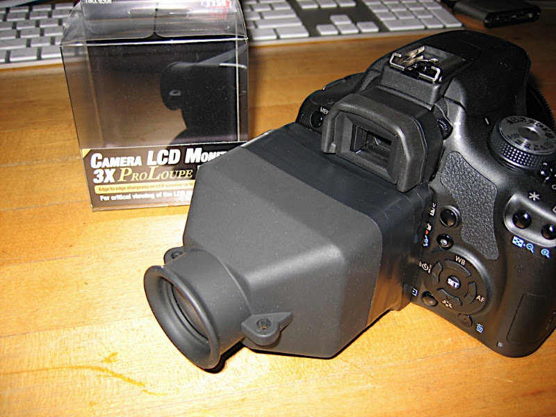

Best of all once assembled it just snaps in place over the viewfinder eyepiece mounting tabs. No velcro or tape needed on the camera body! I can slip it on and off in seconds which is great when I'm frequently switching between stills and video.
And since the loupe is the same dimensions as the screen I can see the entire screen through the loupe and none of the buttons are blocked.
This hood makes manual focusing during video so much easier and even helps to stabilize the camera.
All this cost less than $60. The other low price option out there is the Hoodman Hood Loupe but it has no magnification and attaches to the camera body by way of rubber bands. My ProLoupe has 3x magnification just like the Zacuto (albeit without any diopter adjustment).
