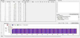

720 60p:
As one just finally migrating to reading more and more about the GH2 now that I've seen the light...explain the burst thing to me.
Is it just that you can't typically shoot these high bit rates at 60p? And so now you can for 8-9 seconds?
That's right. (PV user Jspatz has confirmed that all the speeds will do their predicted times under max stress and are fully stable)
The quality of Driftwood's Seaquake patch really impressed (uncompressed-like), and with the release of this high spec card that can keep up w/ the Gh2, its now possible to come close to that quality at higher speeds w/ reasonable burst times.
