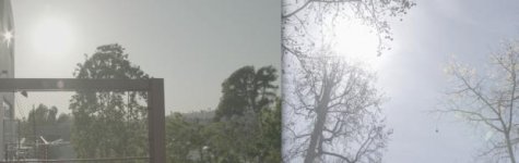

Here's a screencap of some Alexa Log-C vs S-Log2 pointed straight at the sun. Both unmodified, straight from camera. Similar stops, but not identical of course.
First thing I noticed about that short video (aside from it looking good) is his exposure seems spot on for the scene while retaining detail in the sky and a lot of the sun when he tilts up. With that, when he shows the ungraded version it doesnt have that 1-2 stop underexposure look that S-Log usually has when exposed "properly". I guess my assumption or question is, does S-Log2 look less underexposed when set at 33% on a 18 grey? ..or maybe he exposed it a 50%(overexposed) but S-Log2 has so much range the sky didnt clip. That would be nice..
**Ha!, just realized Nate shot it. So replace "he" with "Nate" and with that, Nate how did you expose for the scene?
By eye, since I don't have any proper tools in camera to figure it out.
BTW, that S-Log2 LUT that came from Sony, it is not pulling a 30IRE 18% gray up to 50IRE. I just did some sleuthing in Resolve and figured that out. That particular LUT takes 30IRE and raises it to only 38IRE. Maybe that's the way they want it.
So, using that LUT in post, you can expose by eye and get nice looking pictures. What that means for rated ISO while shooting though, I do not know.
So, using that LUT in post, you can expose by eye and get nice looking pictures, but it's no longer a 1250ISO camera doing it that way. It's probably half that.
I completely follow what your saying. Well if the mids are only LUTT'ed up to 38%, thats surprising as they definitely dont look underexposed. Weird ..and good I guess. Looking at your pre-LUTT'ed S-Log footage in Resolve, do you feel the rough mid-grays(asphalt, sidewalk) came in around 30-33%?
