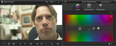

S-Log might extend the gamma curve, but right now it's exceeding my knowledge of editing. Could anyone publish some screen grabs of the color board on Final Cut Pro X using S-Log, something to demonstrate basic editing techniques with ungraded material? Much appreciated. For example, the screen grab below shows an S-Log recorded frame (which by the way was straight to an SxS card) -3db, 3200K, with some subtle illumination from a LitePanels MicroPro. What might I do to improve the image (aside from finding someone good looking.)
Go into exposure tab, pull down mid tones. Boost the master saturation.
I'm finding that's all I need to get a quick, decent look out of S-Log in X until a proper S-Log LUT is released.
Thanks, nateweaver. That's a great start; a practical solution after reading so much goop that I couldn't understand. By a proper S-Log LUT, I assume you mean a firmware update on the camera or in FCPX?
A LUT is a "filter" in an editing or color correction program to take s-log as recorded by the camera and make it look normal.

FCP X is more than capable of making your footage look decent without much effort. If that's what you have, no reason to spend money on something else if you don't plan on getting heavily into postproduction. If you do...well that's a different story of course.
The problem with most LUTs I've seen is they're pretty limited. They are simply meant to make things look acceptable for viewing quickly on set or during a dailies/offline session. Not the same as what you'd want to do if you intend to show off your work and have just a few minutes to tweak color prior to showing a client. Here's a 2 minute color pass in FCP X with screen grabs to show the adjustments.
