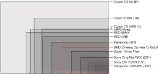

Thanks, I completely forgot about the BMPCC!
But I already have the GH2 and I think the crop sensor mode gives a smaller sensor than the BMPCC? BPMCC sensor is red on the graphic.
I guess I'm looking for 8mm :grin:
Well, I think you're looking for something with a sensor much smaller than anything I would consider using...
Exactly how dark is what you want to shoot, and how deep do you want your DoF?
Because I would rather get a camera with a bigger sensor and then stop down the iris.
With the A7s, you get clean ISO 12K, cleanish 25K, which means you can close down your lens to get deeper DoF. If you compare that with the BMPCC (clean ISO 800, 3x crop factor), the advantage is to the A7s: a 17.5mm set at f/2.8 on the BMPCC at ISO 800 has the same FoV, DoF and exposure as a 50mm f/8 on the a7s at ISO 6400.
Same with the D5300, which has clean ISO 6400: a 17.5mm set at f/2.8 on the BMPCC at ISO 800 has the same FoV, DoF and exposure as a 35mm f/5.6 on the a7s at ISO 3200.
