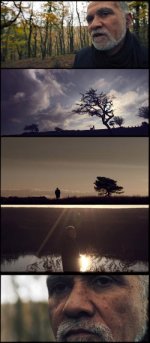

Continuing my weird journey with the F3, which I struggle to get corporate 'popping' colours from but seems to sing on more artsy projects.
Cine1, Grade in Resolve with slight 'off' look - for example blue channel shadows are raised in the first image..
Poet.
So you're having a weird F3 journey hey? I don't know what you exactly mean with corporate popping colours but to me it sounds like you should shoot in a normal rec709 type gamma for that to happen?
Yep im after a 709 look but (well a nikon D3/D600 stills look) with a bit more flex and a little less video/sony/flouro for 'regular' jobs, but not this one.
Do you like the above images?
Very nice Sam thanks for posting.
