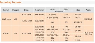

Im not undertanding the codecs.
xavc L = long gop 50mbs seems to be the max in 1080? (or 100mbs in 4k which is 2X more compressed)
quite a lot more compressed than the FS7?

Yes, the codecs are very lean. And with no real output options at this point (?)
It's the weakness of the camera, it seems.

Like the FS7, the 4K XAVC-L is 8 bit 4:2:0. The HDMI will output UHD 8 bit 4:2:2. HD XAVC-L is 10 bit 4:2:2
