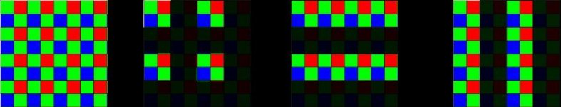

On first image is the full bayer sensor. Setting the OLPF to a single pixel eliminates luma alias. The debayering methods are simple because there is tons of research on the subject in this case. All big companies have excellent methods to debayering a true bayer.
The second image is a camera that can only read 1/4 of the image. There is no ideal OLPF in this case between some green pixels are 1 pixel away and some are about 3 pixels away. If you set the OLPF to one pixel, it will alias luma horizontally and vertically. If you set the OLPF to three pixels, it will not alias but it will be soft. The development method will still have to be very good to produce a good image, even with a heavy OLPF. And the sharpening will have to be a very dedicated algorithm designed for this very task.
The third image can eliminate alias horizontally. It does not even need a different OLPF. The debayering problem still remains and alias will be heavy vertically. An improvement over the second image.
The fourth image is the same with the third image, but horizontally, not vertically.
