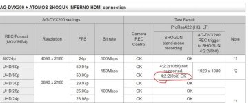

Not sure about Dual 4K recording, But here is some info that I think says you can dual codec record but, internal is Full HD. See images.

No. The DVX200 can never output UHD 59.94 at 4:2:2. When at UHD/59.94fps, it's always 4:2:0.
Furthermore, the DVX200 cannot output UHD at all when it's recording UHD 59.94. When it's recording UHD 59.94, the HDMI output will drop to 1080p for the duration of the recording.
The DVX200 can output 4:2:2 at all other frame sizes and frame rates, but when using UHD 59.94 (and 50.00) it's always 4:2:0.
Hi Barry, thanks for your email. Love your Ebook :) Question, on Panasonic's website, it says 8 bit 4:2:2 "OK", not sure if "OK" means you can send the signal out in 4:2:2, or you can send a signal, period?
