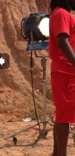

Hi guys, I am a music Video director looking to purchase lights That I can use out door. Say, I am filming out side and it is cloudy or i feel my refectors are not adquate. What lights do I buy and which brand.
I have attached an example.
HMIs are daylight balanced, and are typically used outdoors. AadynTech has some very nice, high power LED lights that I've used outdoors as well. They require a lot less power than tungsten and HMI lights.
