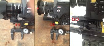

OK here is 'the science'.
FS7, large batt (not Vlock) and EVF onboard also mic (as seen above)
With a lump like the 50-300 the CofM is about 45mm fore of the camera, with a light lens like the 50 1.8 the CofM is about 15mm behind the fore of the camera, my 28-85 is about at 0
So to balance the camera lens one would need about 60mm of for aft.
Ive used a long manfrotto plate which has 60mm of fore/aft in a 577.
Now, my miller sticks have also a sliding plate of 70mm travel but on a HH rig that is discounted.
Conclusion, im configure my rig so that the frotto plate accounts for variance of smaller handhold lenses and have the 70mm travel of the sticks take the slack on the bigger glass.
It should be doable, but it is obvious that the shoulder bump in the camera and most off the shelf 'solutions' is vastly rear of a balanced position.
Also building a rig with the chimney pot and no rear mass.. is not going to happen.
Here the camera is close to balancing on an allen key under the plate.
