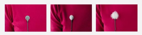

Does anyone know of a dead kitten that will fit the OST 802? I was recording with their foam windscreen on last night and I was still getting some wind noise...Thanks
I like Bubblebee's Windbubbles. There are a few other brands, but I started using these a few years ago, and like them. Available in several sizes and colors.
https://www.bubblebeeindustries.com/collections/windbubbles
A quick glance at their size chart suggests a size 3 or 4 should work since the OST 802 is a lot like the Countryman EMW. But you can measure and decide:
https://www.bubblebeeindustries.com/pages/windbubble-size-guide
The Rycote overcovers and other lav tools are also good (and I use them)...and the stickies seem stickier than they were 10 years ago; that's a good thing. These can be lower profile than the Bubblebee stuff. Worth having several options on hand:

Thanks for the suggestions. Are there any that just slide over the mic or foam cover? The Windbubbles look like they might, but they're a bit pricey...
Yes, I do use wipes. But in this case I did not because I already asked her about the lotion and did not want to insult her. I should have just not asked, but went ahead with the wipe request. Now I wonder if the wipe would have worked or if her skin really was Teflon.
Powder makeup will also weaken the adhesive. If talent has put on makeup, or been through HMU, translucent powder (or any powder) can fall down into the shirt and cause problems with stickies. Or if they’ve been to the gym that morning, sweat and dirt can do the same. Alcohol wipes for all.
The Bubblebees are about $25. I've seen knockoff slip-on lav fur covers, but IIRC, they weren't much cheaper than the real thing from Bubblebee, Rycote, Remote Audio, etc. Maybe B&H has an Auray version for cheap?
Think if you can make the Rycote Overcovers work. For under $15, you get 6 or so fur circles, and a few dozen sticky sheets; You can (or at least could) get a set of different color furs in the same kit. The fur pieces are totally reusable (won't last forever, but will last through a several to a dozen placements if your careful (and lucky). And you can kind of stick them to themselves around a lav. URSA and Bubblebee have similar products for about the same price...I haven't used those but they're booth good companies so perhaps their versions will offer a design feature that appeals a bit more. Anyway, if you can live with tape, you can get 30 days of use for about $15. Not bad.
