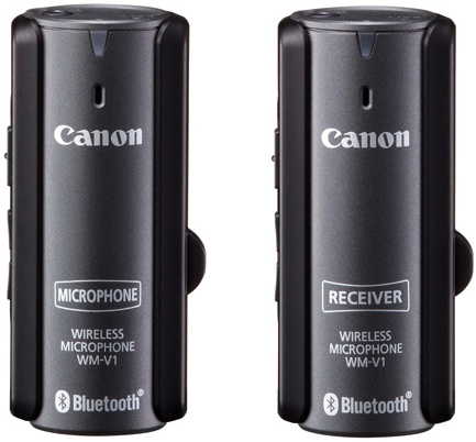

My problem is that I will likely be filming in Japan and I won't be anywhere near a soundguy. It's not just that I can't afford it, but it's impossible. This is really a personal project for the time being. This Canon camera is the gift that keeps on giving however, I'm just after reading that they will release a wireless mic set designed for use with that model and a few others. It uses Bluetooth, which seems a bit odd - does this mean poorer quality? It might suit me as then I won't have to worry about the frequency. If this gets decent reviews I guess I could pick it up for $250 and attach a mic of my choice. Apparently it's good for up to 164 feet.
I'm skeptical about Bluetooth-based mic systems. Bluetooth tends to limit range and mobility much more than traditional radio mics. And that 164-foot range would be under isolated, ideal conditions which you will not encounter outside of a testing lab.

As for the bluetooth wireless, it's not worth it. Do a search for bluetooth here and you should find several threads where the technical reasons for bluetooth being a bad idea for professional sound. $250 will buy you a good wired lav.
