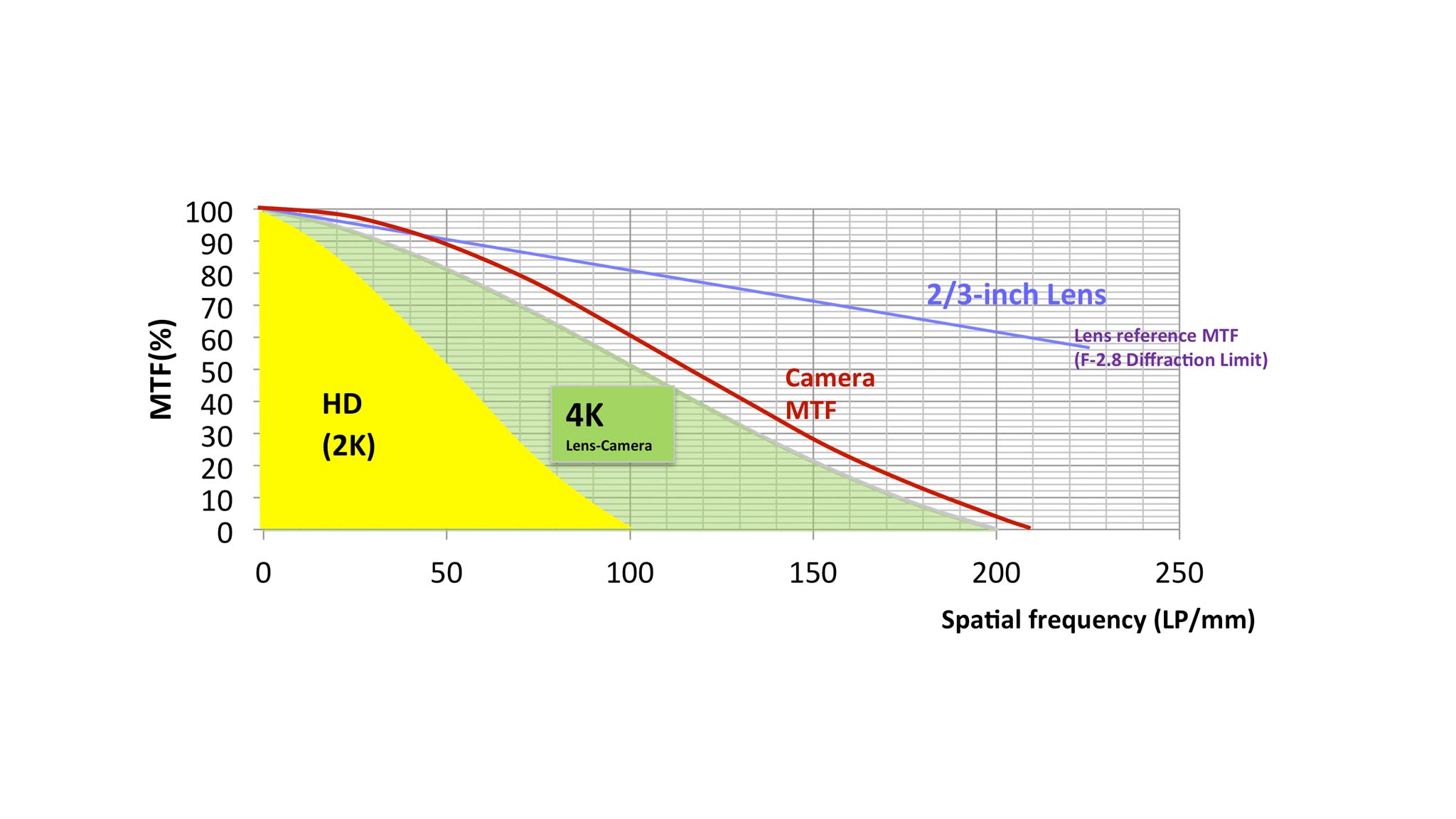

Talking HD here. Every manufacturer rates their three-chip cameras by the size and pixel matrix of the individual sensors, and not the combined result. Therefore, a 2.1MP HD three-chip camera has three 2.1 MP sensors. If the effective pixel matrix is full HD at 1920 x 1080, then the resulting pixel size is approximately 2.5 μm. This requires 200 LP/mm to resolve. This is why good B4 HD lenses are rated up to 200 LP/mm. This is way in excess of the LP/mm resolution required by our FX6 sensor, which will perform well at 60 LP/mm.

An HD lens with up to 200 LP/mm performance and an MTF of 100 is well and truly going to perform very well with the FX6. It is way in excess what is required by an FX6.
Larry Thorpe from Canon broadcast explains some of this tech in his discourse on some of the considerations when talking about MTF, LP/mm 2/3" and 4K.

"An electronic imager has a fixed number of sensors. A lens does not have a fixed resolution. It simply has an MTF curve (or more than one, for different colors, different focal lengths, different apertures, and different focus settings). It provides greatest contrast at minimum resolution and reduced contrast as resolution increases.
So-called HD lenses may be better than their SD counterparts, but that doesn’t mean the SD lenses can’t pass HD resolutions. The HD lenses just offer more contrast at HD resolutions and, perhaps, reduced aberrations."
