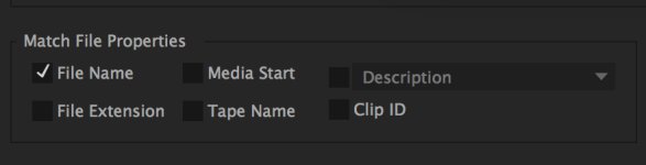

I don't know the wrinkles of your particular workflow, Jason, but I'm re-linking happily in Prem Pro CC2016 from ProRes proxies to the original XAVC MXFs. Just thought I'd check, are you unticking the "File Extension" box on re-link? Sorry - probably teaching you to suck eggs, but worth checking. Pic below to show what I mean.
Yeah, I wish I could say "wow - I never noticed that", but sadly I have. It didn't help at all in a recent situation. I think the root of the problem was the .MTS (C-100 footage) file structure, and the way that AME transcoded into ProRes .MOVs. But I assure you, PP CC2015 (didn't know 2016 was even out yet), was NOT playing ball. :-(
Not at all, any and all input is appreciated when it comes to trying to wrestle the evil behemoth that is PP into submission! :-)
