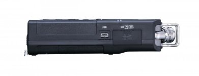

From these pics, the XLR inputs are now combo inputs that can accept XLR or 1/4" inputs.

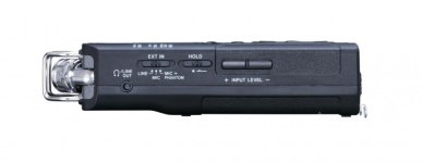

You can see that on the side of the unit there is an external input selector with 3 options. Line in, mic, 48 mic. Awesome! What are the limitations here? May sound dumb but the lower number worries me.

Hi Jive, yes I have mine here in the studio to test. I can confirm that the pressing the Tascam DR-40's Input Level + or - adjusts both Left and Right inputs simultaneously. The DR-40's "more expensive cousin", the Tascam DR-100 offers the ability to independently adjust 1 and 2 with a variable spinning knob.
Thanks Guy. Wow, I really don't understand how Tascam expects the XLR inputs to be useful when you can only set both channels to the same level.
