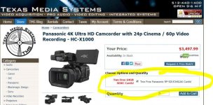

Regrettably I didn't get two free SD cards :( So I purchased a 64GB Extreme PRO U3 card. That should see me through for a little while.
