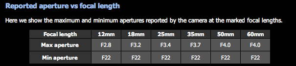

I have the OLY ZUIKO 12-60mm SWD f/2.8-4 (I assume that's then lens you're talking about). It's great for the price. I did a quick short film with it and the ZUIKO 50-200mm f/2.8-3.5. Here's a link below.

One thing to note is the aperature vs. focal length (Source: DP Review). Seems to change quicker than I'd like.
I also have the 14-35mm SWD f/2 but, to be honest, I use them all fairly equally.
