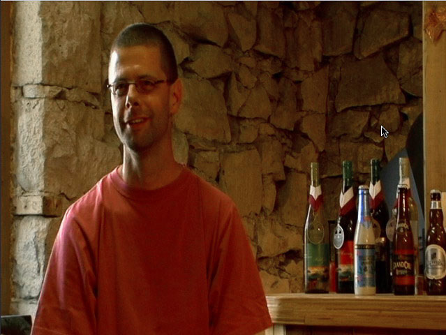

Here are a few grabs. They're shot in Squeeze and taken from the Capture window in FCP so they're a little long. What do you think?

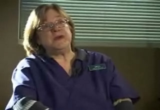

I would say that you were using the sun as a kicker more than a key. The shots seem a little underexposed.
These particular shots might be helped by reducing the saturation (or increasing the brightness) of yellow.
I tweaked one of them in after effects with just curves, hue/saturation, and color balance and got this (mind you I don't have a CC monitor here so it's more of a guess than science):
It was tempting to run noise reduction to help cover up the underexposure. At least this gives you an idea of how far you can push the color.
His eyes are like black holes, you gotta get that dot in them. Maybe if you move him camera right, away from the window, then move the camera left, and angle him so he's looking almost out the window?
