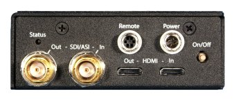

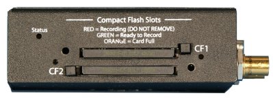

Both the HDMI and HD/SD-SDI outputs are "live" simultaneously. So you can select either the HD/SD-SDI or HDMI input and both outputs are simultaneously available. The nanoFlash actually senses if a cable is connected to the HDMI/SDI ports and automatcially powers down the port (if no cable is connected) to conserve battery life. Additionally, you can program the nanoFlash to automatically go into standby mode (power = 0.1W) on loss of the HD/SD-SDI input (this capability is unfortunately unavailable for HDMI sources). But, standby mode can dramtically increase battery life.
