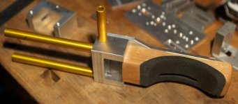

Here are some photos of current adjustable shoulder design.
I am still working out the details and making it comfortable.
I will have more photos soon. I am very busy so I work on this between other jobs. But I feel I have the basic design down. The shoulder pad of cherry and foam is adjustable back and forth. The EVF will move in all 3 planes, and accommodate any EVF.
I will be using a VCT-14 style wedge (like the old betacams) underneath the U-shaped aluminum block to mount to the liquid head. This allows for the pad to be unobstructed and at the same time the center of gravity will be in the center of the head. This will fit fine on any head. I use the Canon TA-100 shorter lighter version.
There will also be an additional plate in the back for large battery receivers etc.
OMG. People. Stop buying parts. Olof this looks amazing!!!!!!
I want to be your beta tester please!
Seriously you are right on target. Keeping the proven ENG design is brilliant. I use a Sony quick release plate now with a Genus adapter and its great. The Canon one is also nice. I had that one as well but my tripod got ripped off. Grrrr.
The rail coming out of the base keeps the horizon flat. Good idea. Nice work so far Olof.
