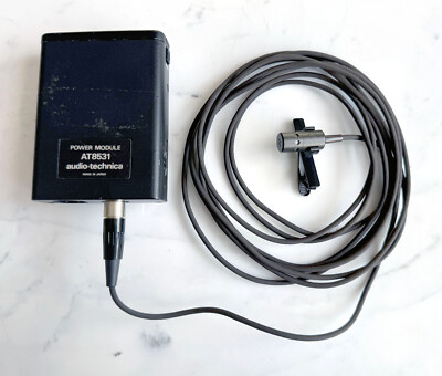

I don’t think that the C100 minijack outputs plug in power. You’ll need a lav with an in-line battery or mini Jack to XLR adapter that steps down the voltage.
The lavs require plug-in power (typically 5v or less) to operate. The C-100’s MIC input does not provide this. From page 76 of the user manual:
Use commercially available condenser microphones with their own power supply and a Ø 3.5mm stereo mini plug.
You can use an XLR adapter, but you need to get one that can convert +48v phantom power to the lower-voltage plug-in power. The RØDE VXLR+ will fit the bill, but make sure you get the plus version as the regular VXLR does not offer the power conversion. The VXLR Pro will also work (actually with a slightly cleaner signal, but whether or not you want to pay the extra cost is a little more subjective).

Maybe use a Beachtek preamp with the C100 (that's what I did):
Get some more life out of your mics and could even use two or three 3.5mm lavs at once (and have much better audio quality).
