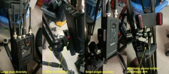

Does anyone have good suggestions or solutions for mounting lavalier receiver packs to a tripod?
Over the years I've had the same question and over the years came up with a variety of different solutions. The ones below have proved to be simple, flexible, solid, reliable and allow a variety of mounting positions. Never had a failure... so far! :)

Mic RX mounts comp.jpg - Click image for larger version  Name:	Mic RX mounts comp.jpg Views:	0 Size:	67.1 KB ID:	5705490
Thanks Chris! The phone holder option looks promising.

I don't have a Senny here to try with the phone clamp, but I'm pretty sure it would work well. The contraction spring in the Manfrotto phone clamp is surprisingly strong. Requires a bit of energy to spread it apart to insert your phone or RX. I've often used two of them for two receivers. I have also mounted them on the pan bar of tripods and C stands, so lots of flexibility with them.

We're going to try velcro to see how it goes, and then maybe move to the Manfrotto cellphone holder + magic arm combo if the velcro isn't to our liking.
