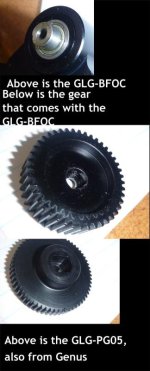

Genus_problem.jpg Genus has a couple things to work out. The Genus pitch gear (GLG-PG05) has cut outs on both sides and the follow focus (GLG-BFOC) has cut outs on one side.
