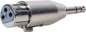

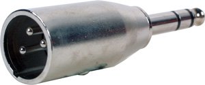

1) If you find the Behringer right, just plug XLR-Jack converters.
Your MIKE -> BEHRINGER -> HVX MIC-IN chain will be asymetrical (audio unbalanced) but except if you have hundreds of meters, it will be fine.

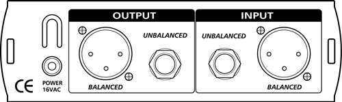

2) These products (less than $100 street) could avoid "a cable factory" and have balanced In/Out, to be inserted pefectly between a mike and the HVX200:

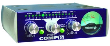

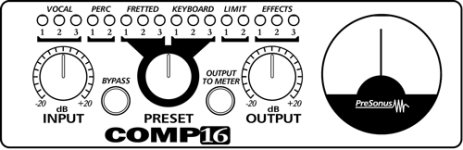

PRESONUS COMP16
comp16-angle-cropped-copy.jpgcomp16-silk-line-drawing.jpgcomp16-bpanel-silk-line-dra.jpg
