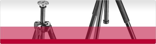

Seems OK, please try if you can unscrew the existing head from the tripod to some thing that look like this main_cat_collections_290series_tripods.jpg Than you will be fine.

and again yes the 701 and the 500ah would fit on your tripod. The 502 would not because it comes with a 75mm bowl, which is a different mounting style.
Except for the head that use the bow type, your tripod can fit any flat base type head
you might only need to but a heavier weight to hold the tripod down if the head is too big.
