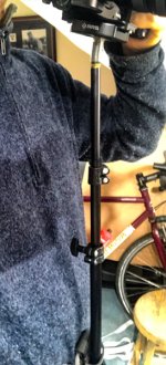

Also use an old spring rod for my hand held work. If I am holding it for hours on the water in a boat this is excellent. Use Arca type plate on the camera and Kessler on the tripod. So on top of the spring arm is a RRS receiver. Fast, easy, and one more excellent way to stay steady with the great stabilizers the camera offers. Great to repurpose old gear that has been around for 10 years and not touched.
Sorry for the long post, but thought some of the gear might help others.

"Also use an old spring rod for my hand held work."
Could you explain this a bit please?
So…back in the day…a lot of us used to shoot with cameras like the DVX100. When shooting handheld, or for events, we’d use a waist belt that had a little pouch on the front of it. The camera would mount to the end of a spring-loaded rod (and a little rotating ball-head type thing), and the rod would sit in the pouch. It took a lot of the load of the camera off your arms, and added a kind of “poor-man’s steadicam” function to the rig.
When the operator moved, the spring rod would “soften” some of the movement, which helped make for steadier (though not entirely steady) shots.
Thanks Stephen, Spot on. Used it back with my EX1 starting in 2007.
Even with the stabilization in the S1H it helps a lot. Especially when I have long days handheld. And to remove I just have a RRS quick release on the end. Nice to reuse old gear.
If you look in the picture and go to details this is the same rod I own. I am sure it could be on ebay. I have two but keeping the second as a backup. The springs do go over time. You also need the rubber universal at the top with two 3/8" threads top and bottom to go into a plate. Again those soften up over time so way back I bought a few extras.
I am sure you could make it.
