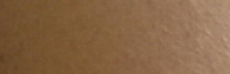

I've included a sample image, i've emphasised it a bit and it's 200%, I can find it in all sorts of footage but not universally over a whole frame, it appears in different bands of luminance in patterns and situations i've not been able to understand.
What i need to do it to recreate this reliably. It could be the recorder (shuttle), the recorder settings (dnxhd), the cable (hdmi or SDI) or the camera. If i can grab some sample footage or get people to look at their source very carefully, looking for this pattern, that would give more weight when i speak to sony about it. If it's in anybody elses footage that points to the camera itself.

I've emphasised it, most of the time it's pretty subtle but because of the postwork i'm doing i'm looking in a lot of detail at the footage. Of course once you see it then it becomes easier to spot it but that's compounded by the fact it's not universal or everywhere.
It could be as simple as a rounding error with various colour conversions down the line. Although i feel that it's unlikely to be the shuttle because i had two of them and the one connected to the FS100 does not show this. Also if it was the shuttle then i'm sure lots of people would have identified a problem.
I'd considered cables, because at that time i was using HDMI rather than SDI. But then i don't think cable issues would produce this kind of pattern either, i could be wrong.
As i mentioned above i need to find a test case and quantify the issue more but anyone that's running a 700 to an external recorder i'd love to see a frame or two.
