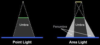

I think there is a little confusion here.
The softness of a source its physical size.. a 1.1 will never have the soft wrap of of a light bounced into/through a 36 brolly or a 8.4 scrim.
The 1.1 panel with a diffuser will have less multi shadows issues than a regular 1.1 but it will not be a softer source.
Id personally go for power in the fixture and either chuck on some frost or use a physically much larger diffusion away from the fixture?
From the B&H description of the Litepanel Astra Soft...
"The diffusion is designed to all but eliminate the multi-source shadow effect and lend a soft wrap-around aesthetic to your subject while covering a larger, less concentrated area of illumination."
So is what they're saying regarding it lending a soft wrap-around aesthetic incorrect, or am I misunderstanding that when I think that to mean it creates a softer light?
And again at 2:00...
"You can see how much more diffused that light is, and it looks like one light source. It looks like a much broader light source. Look at the way the light wraps around her face. It's the same size, but the quality of light is significantly different, and it's actually light you can use bare." - Vincent La Foret
Is he wrong too? Are these products being mis-marketed? Am I misunderstanding what he's saying? Or is the size of the source not the only thing that affects softness?
Yep I think the B+H wording is misleading.. and Vincent is talking utter BS.
You can only wrap with a large (or close) source. It is physics - light does not bend.
About killing the multi shadow effect that is true.. but a $1 bit of frost does that too (if a bit scruffy)
A wrap is caused by large penumbra which is physically caused by a large source penumbra shadow
