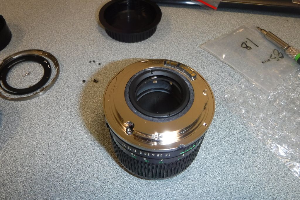

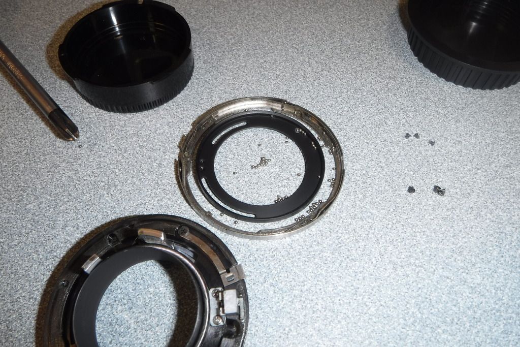

The reason I wanted the zoom is it is supposed to be parfocal, I'm not done messing with it but I need to get it open so I can clean the fungus out. Then I need to get infinity focus adjusted and then back focus so that it will again be parfocal. Not sure if the other FD zooms are really parfocal, none are listed as such when I do web searches. Figured a zoom would be handy for a few things as it would be normal to short telephoto or slight wide to slight telephoto with speed booster. So my fooling with FD lenses may be pretty short, the Mamiya 645 lenses are just working better for me right now and with the long flange distance should work on just about anything with an APS-C sensor or full frame sensor. Not sure if they will cover the new 65mm sensors but they might just clear the corners at some aspect ratios, ideally they are 56mmx42mm frames, need to calculate the image circle.
