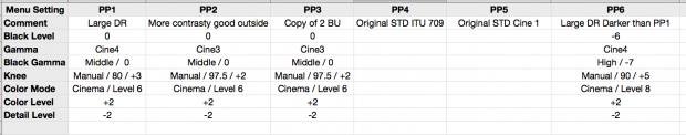

Here is the PP's I use most of the time:

Thanks for your presets, I am going to try them out. I really wish we could name the presets in the camera.
