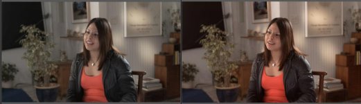

Straight out of camera. SLog, 709 (800%) lut to SxS cards (Media export from Premiere as TIFF, then converted to jpeg via iPhoto):
Frame on left is straight out of camera, frame on right is with minor color grade:
Thanks Douglas. This was just an experiment for an upcoming shoot.
Today I had a two camera setup (Varicam 2700) at proper angles. Then I just squeezed the F3 off to the right to see how the Rec709 (800%) LUT looked and if I was understanding exposure.
