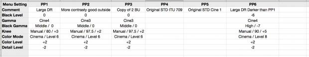

Sorry to derail the thread slightly, but would love to hear/read the profiles that you use to cut between the fs700 and EX3 Olof. Cheers!
I use my profile 2 on this chart for the 700

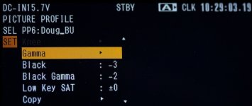

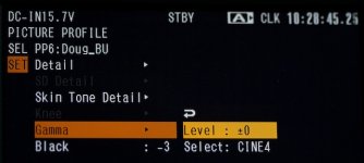

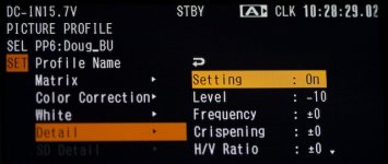

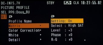

And these settings for the EX3:
This gets you quite close, some grading in post will make them match perfectly.
That's great, I'm going to give these a try next time I'm on a shoot with them both (it happens often!). Thank you so much!
