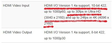

So you think that Convergent Design has an 4K issue wih their HDMI input? Or was it Atomos? Because the specfications are near to the same for HDMI!
Both perform UHD resolution up to 3840x2160 with 30p and 10bit 422 only. No wonder since it is the same outdated HDMI 1.4a/1.4b interfaced interface in both products.
The 7Q+ performs also 24p 4K DCI (4096x2160). This is not performed by the Shogun 1. Maybe that is of interest for Cinema productions, but not for other productions in 25p or 30p. But even the 7Q+ is not capable of 4K DCI (4096x2160) for 25p or 30p using HDMI as one can read from the specifications.
Which deepens the mystery.. if Shogun and 7Q+ have the same spec'd HDMI port, and one supports DCI 4K at 23.98 FPS and the other does not, it just demonstrates that not all manufacturers adhere to the port specification. No matter what I have tried, I have never been able to get DCI 4K video to appear at 23.98 FPS on the Shogun.
