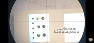

It looks like hunters and other gun owners are recording their shooting with iPhones strapped to their scope. Nothing about the footage would look any different if you took a telephoto lens and closed the aperture way down to give it some diffraction and then overlaid the crosshairs and circular vignette on top. The distinct look of the footage is the shakiness and rifle movements.
https://youtu.be/5GQjpVJCyqQ
