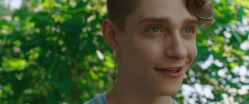

Here are two random stills from some amazing footage of the camera being left recording whilst walking around set. ND 1.2 was in the matte box I believe
There is no unnatural colour shift to my eyes (besides the F35 being warm in general)
Very nice! In the youtube test there is a perceivable green shift when the filter is added. It's very slight, and if i wasn't shown a before and after shot with the filter I probably wouldnt have been able to tell the difference, VERY nice filters. I'll see if my budget allows for them. Thanks again for the reccommendation!
