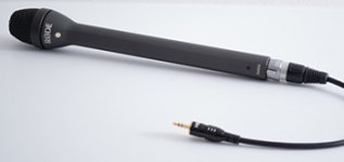

Or, maybe I am completely wrong and what you are seeing in use is not the RE50 but the Rode Reporter, which is a long-ish mic:
Shure's SM63 reporters mic is available in a extended reach (long) version (SM63LB) of their I think Beyer may as well.
