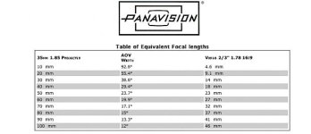

Your calculations are a few stops off. A 23mm lens in 2/3" chip has the same field of field as a 50mm lens in 35mm (xferred to 16:9 broadcast). 23mm at a 1.4 at 10 feet gives you a depth of field of 3 feet 6 inches. 50mm at 5.6 at 10 feet away give you a DOF of 3 feet 6.5 inches (essentially the same). The stop differential to match Field of View and DOF between 2/3" and 35mm is three stops. A 2.0 in 2/3's is a an 8.0 in 35mm.
This is probably the reason I've never been sold on the notion that digi primes wide open give you 35mm like DOF. I like the look of 2/3" with an adaptor much better than a d primes wide open. D Primes still look like video to me. Just very sharp video.
On topic:
One of the main differences I find with the HPX is that it's far less noisy than the HVX. For a film out, the HVX noise in the darks and certain color signals would give one a severe migrain. Also the light sensitivity of the HPX, especially when coupled with an adaptor is still more sensitive than an HVX without. If I were doing a budget minded feature and wanted a "cinematic" look, a 2/3" chip camera with an adaptor would be a strong option. For web stuff, the sharpness/noise differences between the two cameras isn't as much an issue.
Tim: Not trying to bash you in anyway, but what chart are you referring to for your information?
I think you are accedentally comparing the 9.6x5.4mm (2/3" 16:9) to the 24 × 36 mm (35mm still photography) were the conversion factor is about 4x (actually more like 3.9x). That would explain why you are saying an f2.0 in 2/3" equates to an f8.0 in 35mm.
The conversion factor from 2/3" 16:9 to s35mm is 2.5x so a 24mm lens @ t1.6 (which really is an f1.45) on a 2/3" 16:9 chip would be equivalent to a 60mm lens @ f3.625 (an f2.8-f4 split)
Am I missing something?
Its easy to get a a very similar DOF to super35mm with 2/3". Most of your shots if you were shooting s35 film would be at around f2.8-f4 anyways.
Tim, go to your local rental house and slap a digiprime on a 2/3" body. You wont be disappointed!
My apologies if my math is incorrect, check with Panavision for more accurate information.
-Hunter
-Hunter
Am I missing something? Take a look at the charts. Give or take 1/2" the FOV and DOF are virtually the same. Got them off Panavision Australia.
Let me know if I got the inputs wrong.
re: Digiprimes. Last year I shot a feature Vanessa Williams with w / Digi primes and they're the best 2/3" will ever get. But I still find it's DOF a ways off from 35mm like DOF. It especially shows in the wide lenses.
Tim Naylor - DP
www.timnaylor.com

Maybe the subject distance is throwing me off. I noticed with 2/3" that if you pull your subject distance just a little closer (like 6' instead of 10') The dof gap from s35 and 2/3" gets much tighter.
Ok now back to HVX vs HPX film out...
Funny you mention this. I used to think the exact same thing that a 1.4 was app a 2..8 in 35mm. Maybe it was the Silicon Imaging lit or the way rental houses were always trying to push D primes on me and I woke one day and believed them. Then after some disappionting results with wides I decided to go the Panny charts to see what's up. I coudln't believe my eyes. I wasn't expecting a 3 stop difference.
Now I know why lot of old 70mm films were shot at 5.6-8.
