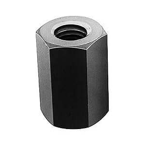

What you want is a couple nut. 1/2" to 1/4". Make sure you get the threads correct. Take a tripod plate that fits your camera with you, and the boom pole.
The coupling nut will be female to female. You need to buy that piece as well as a 1/4" threaded bolt and some red loctite.
Basically, what you are going to do is to thread the bolt with no head on it (threaded rod) into the 1/4" side. Do a test fit first to make sure it's going to work, then do it with the red loctite. (*WARNING* When you do it with the red loctite it is NOT coming out.)
Now you'll have a female 1/2" end, and male 1/4" end. Problem solved. Your reducing coupler will look like this:
All told, this stuff should cost $10-$15.

ace hardware in town was able to give me something that should work... we got a reducing coupler and then he just cut the head off a screw that will fit in the bottom of the camera and in the coupler
$4 for it all... well not counting the glue for the threads...
