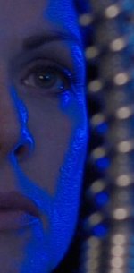

I've also seen a few cases of extreme math/clipping problems with debayering in very saturated light (blue specifically), the 100 was way worse than the 700, ruined a few shots too.

As for the "extreme math/clipping problems with debayering" I'd love to know what that means but more importantly what that looks like.

I've enclosed a crop, i have to be mindful of full frames for various reasons but this shows you what i mean. Strong blue filter on a dedo, pure blue. Sent the highlight handling of the 100 crazy, this was with Franks last profile. Blue has clip completey as you'd expect, there's no red light but the green just went a bit odd, solarised almost. The 700 version (different angle) is much more controlled, i'll have to see if i can find a suitable frame there. It's still not perfect on the 700 but usable.

i'd want to try it again without the fauxlog profile, in my case i find them to be the cause of clipping.
Still might crap out on that shot tho, just later and smoother with another profile choice
d
@Paul
That's interesting. I recall someone posting a still from inside a nightclub where there was a black ring round bright lights. It was never pursued any further.
I have seen this in news footage of emergency vehicle lights which more than likely won't be Fs100s (but likely Sony cams) so whether it's a setting issue or a feature of Sony cams I don't know. I'd be interested to find out.
