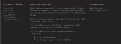

*1x video camera (with the specifications on the image bellow)

Regarding the HD video camera (so far using HDMI interface (with blackmagic design capture card) looks better alternative)

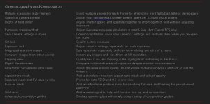

and the cinematography features (provided by the software)
i have "signed it" with a blue line. means i think some of this features are available for DSLR probably not with Video Cameras. (i will have to contact the developer for clarify that issue).
so far those cameras Grant refered they seem to have the features that i am looking for (but no HDMI plug output, just Firewire output).

focus, aperture, shutter speed and everything else should be "fully manual". For this reason i mencioned the manual lenses also.
The developer says: "..Graphical camera control: Adjust your still camera's shutter speed, aperture, ISO with visual sliders..."
Like i said, i am not sure yet if i could manage this through video cameras!
