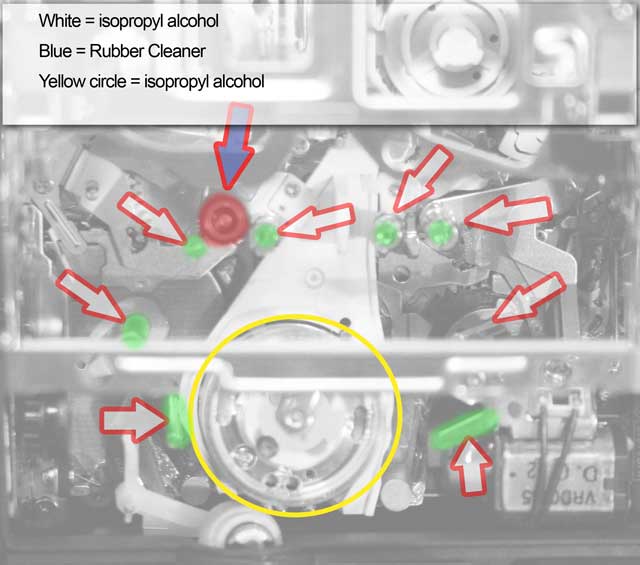

Guide To Cleaning The DVX100(a) Recording Heads
"I've cleaned many heads, from 3/4" U-Matics to Digibeta, never have we used chamois, only disposable lint free tech cloth. When asked why, my boss stated chamois can snag and damage the heads. He does use the chamois swabs to clean capstains and rollers."
Your boss is correct, one should never use chamois cloth for cleaning heads and drums only stationary head like control track and audio.

Man oh man. I am such a freaking coward. I was going to purchase ALL of the necessary items to clean the heads on my cameara. Oddly enough, as bad luck would have it, I received the RED X OF DEATH on both cameras within a week. Well, there is SO much conflicting info on this thread...use chamois, DONT use chamois, never use rubber cleaner, USE rubber cleaner....ugh! Rush, I think I am just going to call you and order 4 cleaning tapes. Two to get her done now, and two for future emergencies.
rlm7189: cleaning tapes can be used more than once. just never rewind them. one cleaning tape is enough for many cleanings.
Andrea
That's true rlm, you just one for maybe a whole year. I can also tell you it is always safer to clean the heads manually than with the tape, that is really just a last resort. Imagine it's like sandpaper on teeth rather than a toothbrush :huh: These guys also do a good job keeping all our rental cameras serviced regularly:

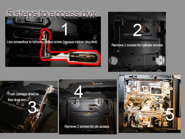

5 step easy access to DVD cylinder
Thank you Barry for the great info.
Here are some guides to assist others with access. These guides must be used with the instructions provided by Barry. They are to too vague to use alone.
Chris
