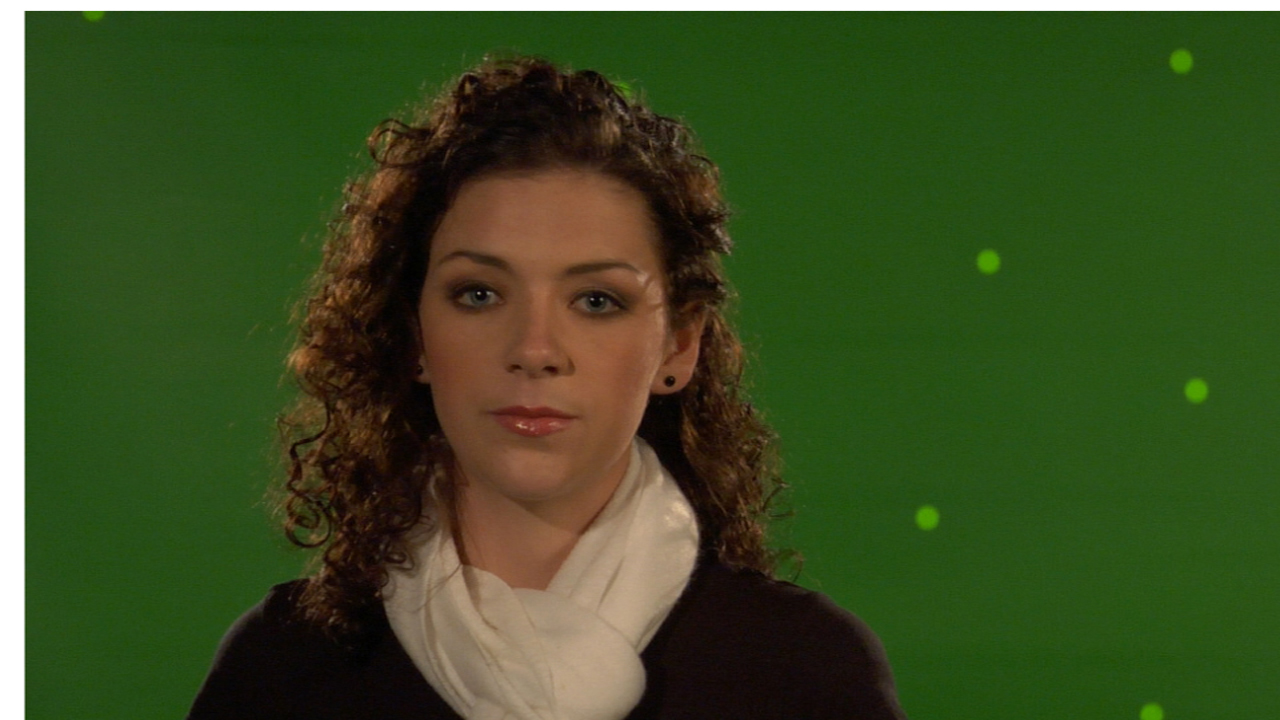

So I shot using 720p DVCProHD, 1/120 shutter, 37fps), and it was remarkably easier to key than I thought, but I wouldn't say plain sailing. the director was very suprised of the outcome, cause they're used to seeing HDV footage key'd that is a lot harder than DVCProHD to key.
It's a low budget music video, we have about $2000 for everything.
The green screen footage is for cut away shots, next week we will hopefully shoot the main body of the video if we get the 2 locations locked.
The greens screen grab (RAW OUT OF CAMERA, no prep yet, just moved the comp a bit in AE hence the white border):

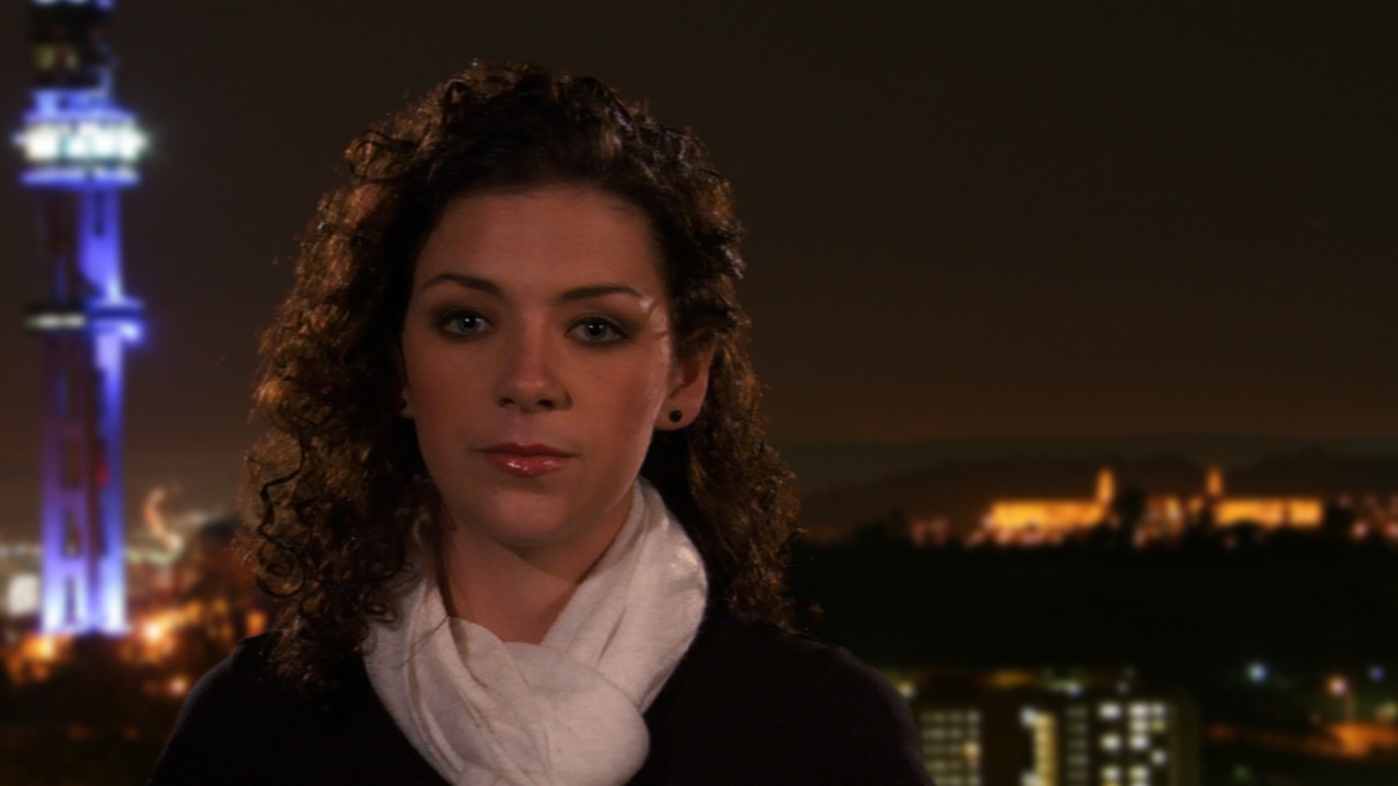

and the SLAP comp (just to check the key). I used Keylight to pull a key.
what do you guys think? descent key or waisted effort, he he?

thanks I appreciate the feedback. I was paranoid on set, he he, I used seven lights in total.

did you try the neat video plugin? I heard it's really good to put on greenscreen prior to pulling the key. Supposidly you can then key the video, composite it and then add the slight grain across the whole composite.
Excellent, around the hair are the trouble spots, does it sizzle or fray when she moves at all or bleeding into the foreground. its hard to tell with mp4?
There are many masking and edge removers out there if so, what software is this?
You could try matching the key lighting with what the background will be, so it will appear more seamless.

yeah there is a slight sizzle around the hair, but if I do seperate keys for the edge hair, and for then for the rest, that is resolved.
I should do an experiment and run it through neat first, and see what that does.
