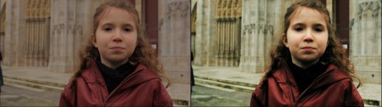

i think i've mentioned before that i'm experimenting with custom curves in order to get as flat an image as possible for easier grading. here's a test, i'm very happy that there's so much info that can be pulled out compared to, for example, hdv, and that by compressing them in the middle it seems like you get less artifacts.

i don't know if it's the screen grab function or the jpeg compression, but there are actually no clipped blacks. just disregard that, the rest looks like i intended.

is that a no curve Vs. custom curve or is there some post?
I believe obvious answer is the image on the left is the custom curve(amazing!), and the image on the right is an extreme colour correction to show what detail can be pulled out.

??? Maybe you can explain what the images are that you uploaded. I see a before and after set of pictures where the 2nd one is much more contrasty and oddly colored than the original. Are you saying these are not before and after pictures? Are they "after and before" pictures?
Is the neutral preset not truly the most neutral? Or are you flattening out the heel and toe of the curves to preserve detail in the shadows and highlights?
bandana dan got it right, the first is directly from the camera with the custom curve and the other is after grading. i did a rather extreme grade in order to see what i could pull out of such a flat image, even if you don't like the result aesthetically you can tell that it's technically good even after that much correction. the theory is that the camera adds noise and blocking to the shadow areas and clips the highlights both due to compression and conversion from linear raw to 8-bit video gamma, and by doing this i'm trying to avoid both, plus it's always easier to grade a flatter image no matter what. the test is to see if you can recreate a contrasty image, and my result shows that yes you can. i think the result is much cleaner than if you would have shot with a high contrast to begin with.
