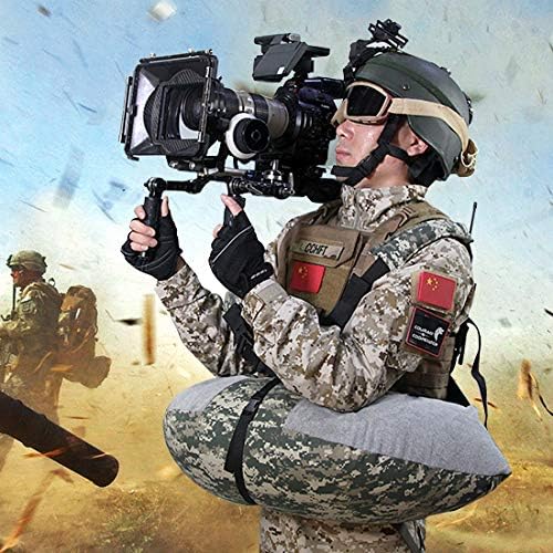

This is like the Cinesaddle but with shoulder straps and velcro straps on the back. In practice, the weight is distributed between shoulders and lower back / hips.
https://www.amazon.com/OPENMOON-Camera-Chest-Supporting-Grey/dp/B079QX23SC
Sweet Baby Jesus... There IS something that looks more ridiculous than an Easyrig.
It’s like an inner tube/pool float with shoulder straps. I’m having flashbacks of cartoons with hillbillies wearing barrels with shoulder straps/suspenders.
That's one of the best product photos I've ever seen. I would for sure try the openmoon d bag.

I don't know if I could bring myself to use the OpenMoon. I think I can grasp the relief offered by the design but add to this my production regular knee pads and a light meter dangling from my neck, and I'd be an SNL skit.

"I don't know if I could bring myself to use the OpenMoon. I think I can grasp the relief offered by the design but add to this my production regular knee pads and a light meter dangling from my neck, and I'd be an SNL skit." The guy in the (comedy) picture must be tiny - it's not that conspicuous. It's certainly not as conspicuous (or as ridiculous-looking) as the EasyRig. Although relative hilarity is a judgement call.
I'm also too tall for shoulder mount. The OpenMoon means I can switch between low chest height (camera resting on support) to just below eye level (elbows resting on support).
