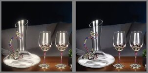

These days, I hardly ever use filtration on the lens. Shoot naked images, and almost anything can be done in post these digital days. Below is #1, a simple image of some glasses. The left side has the Tiffen software "Bronze Glimmerglass #10" applied to it, with no additional filter adjustments applied. The right side is the original.

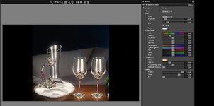

#2 is a shot of the Tiffen FX control panel. This gives you access to a massive range of filtration parameters that can be adjusted within any filter node that is applied. So much more freedom to get exactly the look your client wants. In Resolve's color Tab you can of course 'stack' filter nodes, diffusion, color enhancing etc. etc. Like stacking filters in a matte box. But all done in GPU 32-bit floating point math. Love it!
