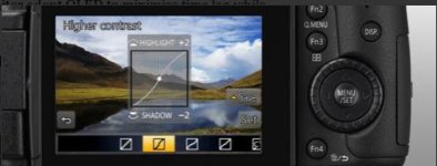

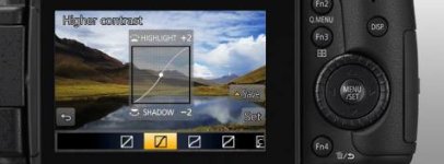

GH3 GH4 Gamma curve settings screenshot?
Why has nodoby jumped on this? This is really exciting. First, the inclusion of Cinellike D and Cinelike V profiles. And then customizable gamma curves, in addition to presets? This is great news. It looks like one of those is LOG-ish.
This really is awesome. Really an awesome and most welcome feature. Almost makes the lack of body changes acceptable! :)

if you want to see what it is about with and existing camera go to a camera shop and ask to check out an omd em5 omd em1 pen e5 or gx7. olympus was the first to implement. however read the online manuals first the salesperson probably will not know what you talking about. on the omd em5 press the fn2 button. if It does not come up someone has changed the default, ask the sales person to reset to factory settings or do it your self menu....camera image1.....reset/ myset.....full....confirm
on the olympus cameras the highlight curves adjust is not very aggressive, I have never tried the gx7. at high isos noise of course gets pulled up with the shadow adjustment. not really a gamma adjust, more like a rudimentary HDR adjust. does not increase dynamic range but increases usable dynamic range reducing the crushing of your shadows. as said on the olympus cameras the effect on the highlight side is more subtle. then ask to see the gx7 and don't leave until the sales person figures it out, it will do him good.
