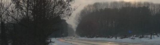

original AVCHD
AVCHD after 5D2RGB
Shot with a GH13 and 2x anamorphic. Stretched in AE CS5. Maybe it's too soft to give you an idea. I think it's a significant improvement. Look at the difference in detail on the road. (Mind the red flare, that looks like a reflection on the road.)
I know it's not a GH2, but then i don't have one![]()
No, that's fine. It is a significant improvement and it looks great! I think I'll be hijacking my girlfriend's Mac until this gets ported.
original AVCHD
AVCHD after 5D2RGB
It is very difficult to make a judgement because the anamorphic lens strech etc which produce a very soft image. The only thing I see is a lower contrast image, but it can be me not seeing the difference.
